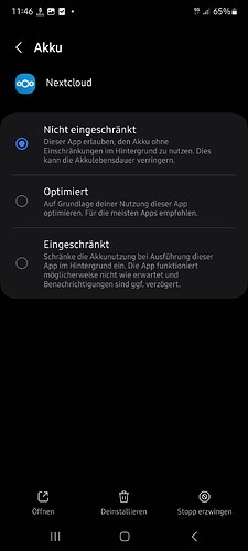

I have already deactivated Allu optimisation, even though the message is displayed every time. Upload only when battery is charging, etc. is also deactivated.

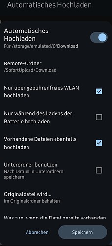

Can you please post screenshots of the app-settings as well as the settings in “Automatic upload”?
I tried to change the language but I don’t find the point
Thank you.

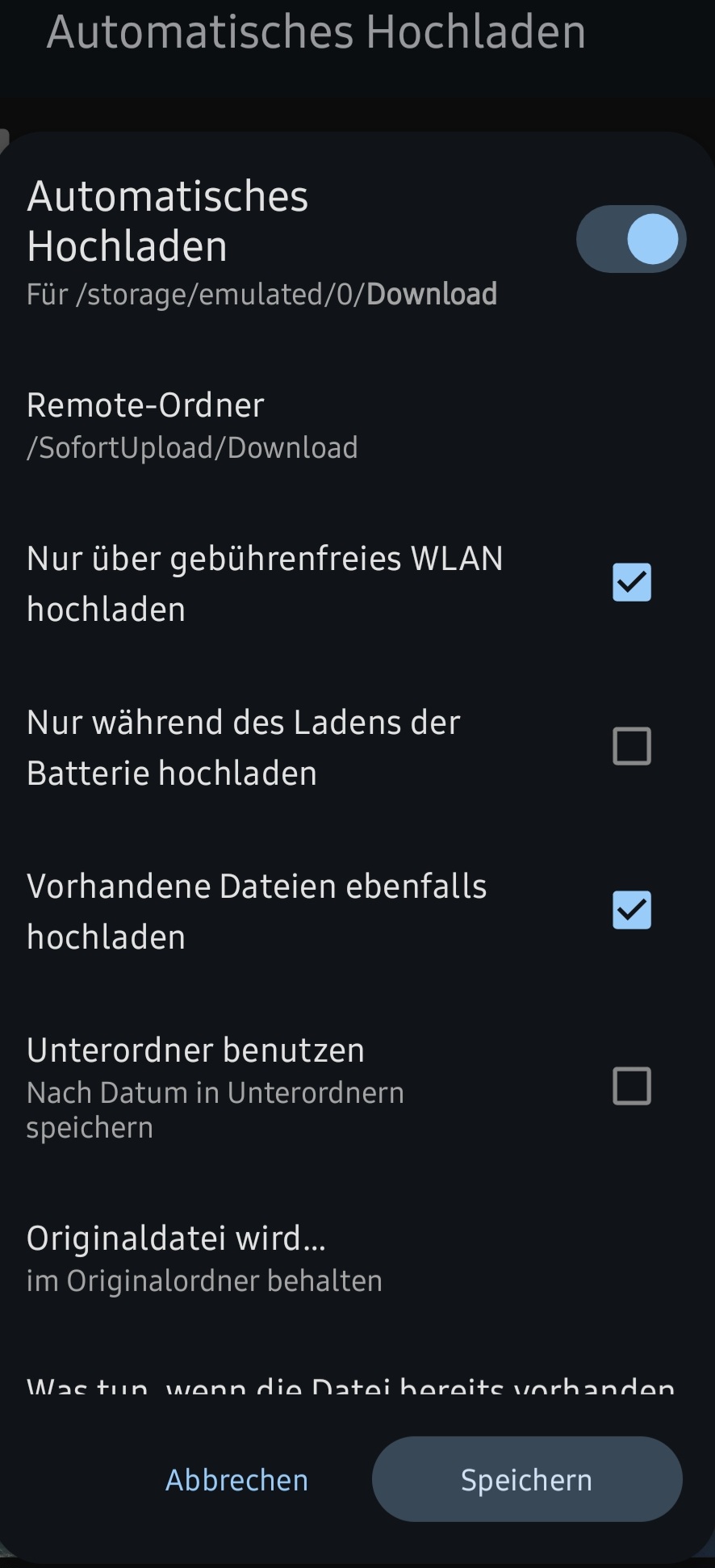

I recommend, first to deactivate “Nur ĂŒber gebĂŒrenfreies WLAN hochladen” ans please check the settings “Was tun, wenn Datei bereits vorhanden”.

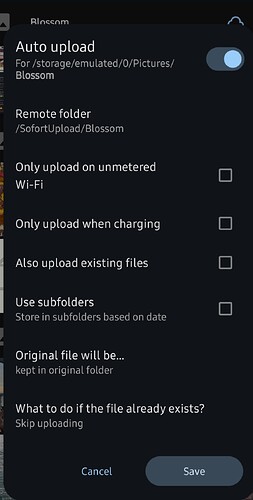

You should set “Overwrite server files” or “Skip upload”, because the default “Ask me every time” needs manual conflict-solution, which not directly appears on screen and leads to cancel upload after a while.

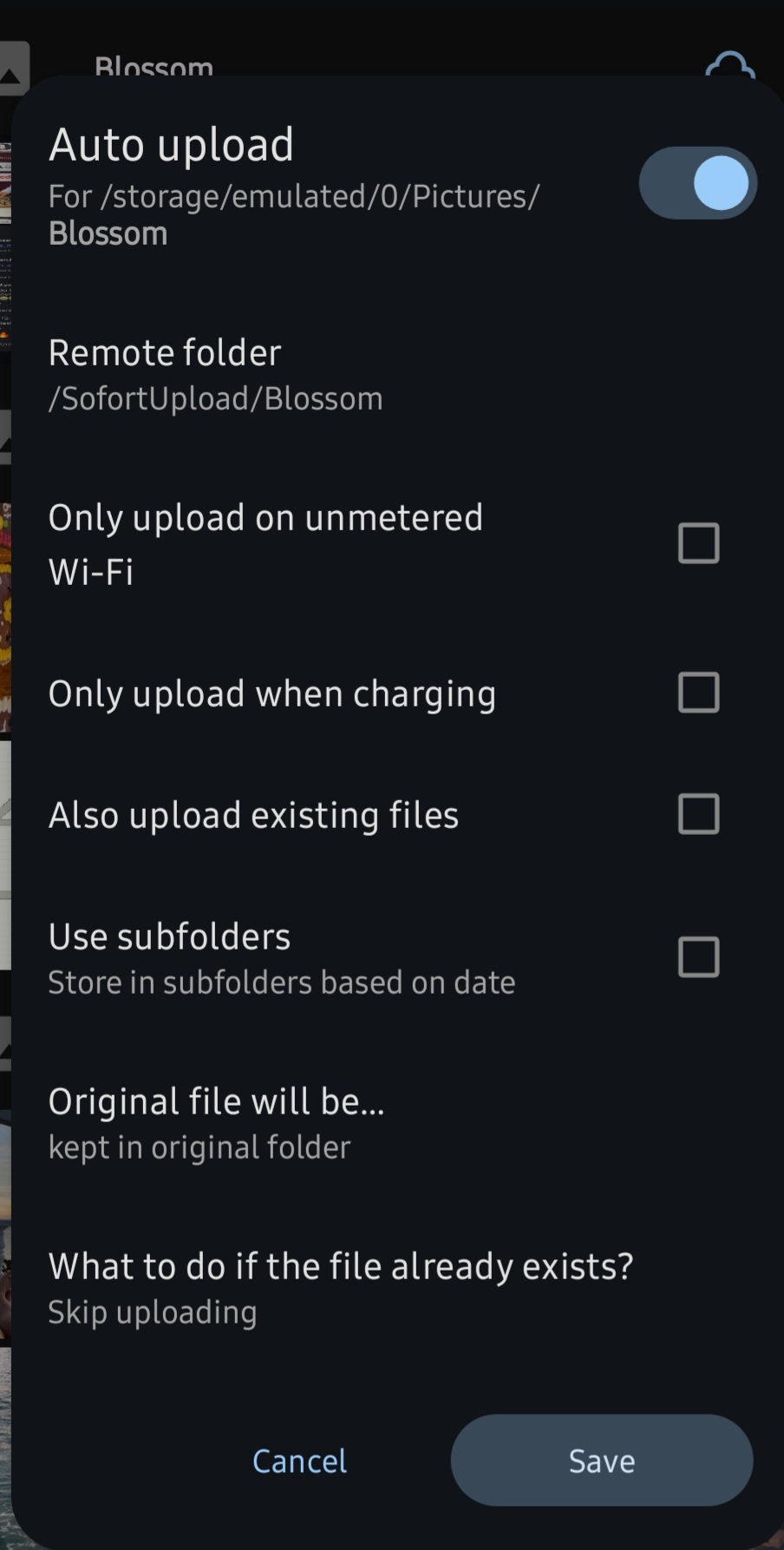

This are my settings now.
Haha, I got it. The Nextcloud app still seems to be buggy. I just had the same issue in my wife’s Xiaomi 13T Pro.

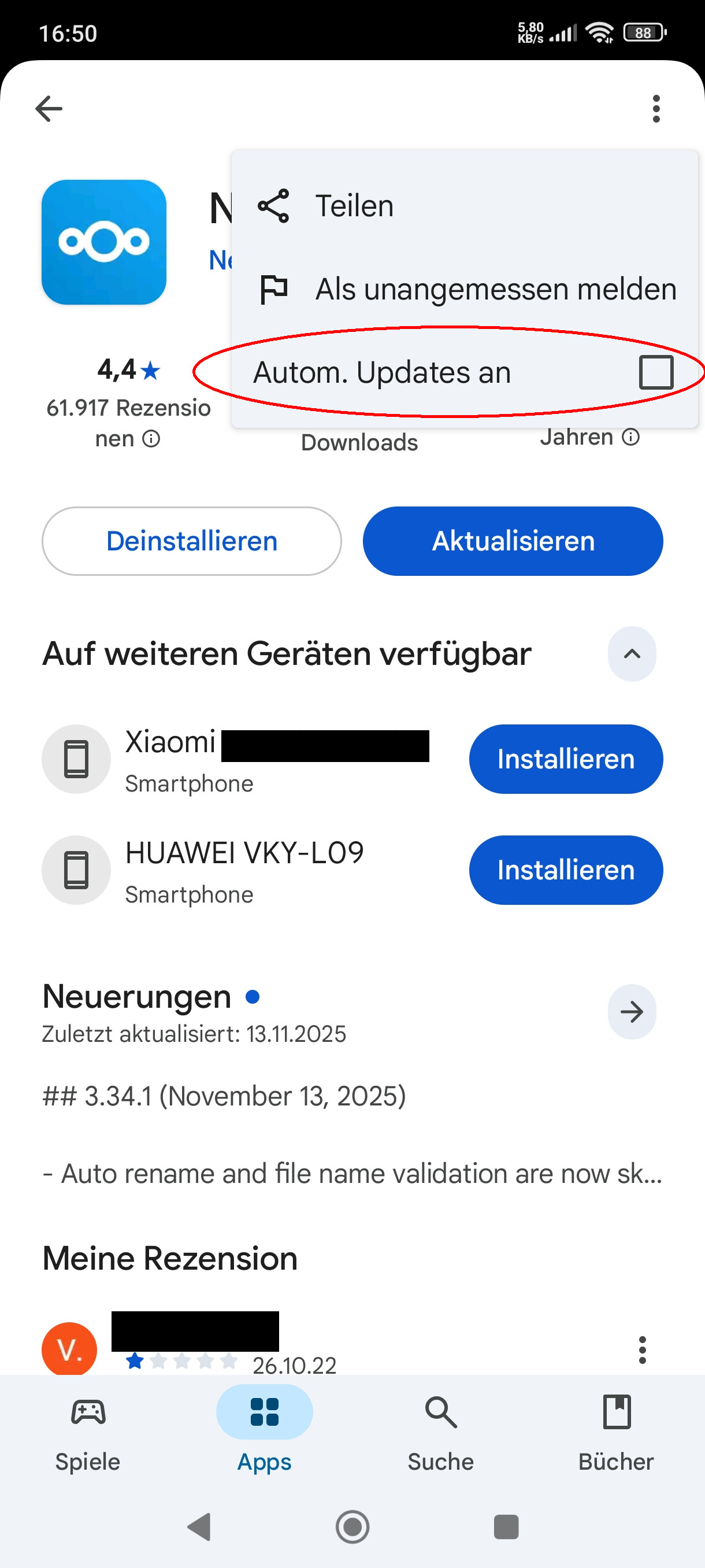

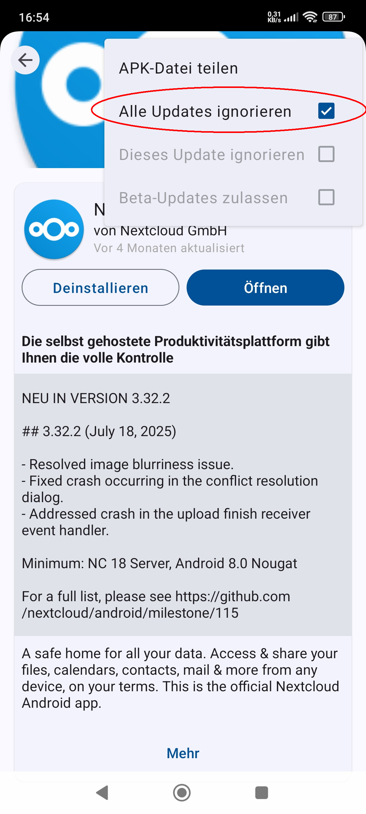

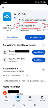

In that case take care to disable automatic update in Google Play-store as well as in F-Droid.
Google Play:
F-Droid:

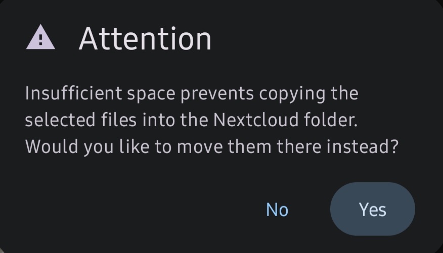

Hello! What does this message mean? I selected the ‘Keep file in source folder’ option during manual upload.
I never had seen that message. Maybe it appears in the latest version only,
I always keep the pictures on my device. Since Google did some changes in the permissions of 3rd party apps, I do not know, whether “move” will work again.
