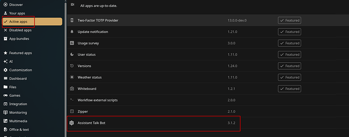

  • The Assistant Talk Bot never shows up in the list of bots / conversation settings.
  • I tried again recently, but nothing has changed.
Current environment:
  • Nextcloud AIO: 11.9.0
  • Nextcloud: 31.0.9
  • Assistant Talk Bot: 3.1.2

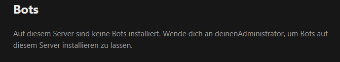

Hi all,
I’m faced the same issue…. Nextcloud assistant installed, bot created, but unable to add bot to a conversation. Within the conversation settings:
I worked around with a room:
root@nextcloud ~# occ app:list --enabled | grep assist
  - assistant: 2.9.0
root@nextcloud ~# occ talk:bot:list
| id | name   | description | error_count | state | features |
| 3  | uptime |             | 0           | 2     | response |
root@nextcloud ~# occ talk:room:create room1
Room token: 5anoopw7
Room successfully created.
root@nextcloud ~# occ talk:bot:setup 3 5anoopw7
Successfully set up for conversation 5anoopw7
root@nextcloud ~# occ talk:room:add --user=admin 5anoopw7
Users successfully added to room.
root@nextcloud ~#
