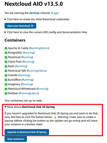

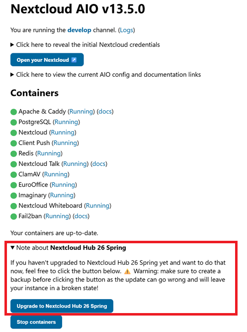

I’m seeing the same kind of update blockage when AIO reports that its app is incompatible, even though the server is still on the 34.0.1 line. Recreating the containers and images produces the same result, so the version check appears to be the part that needs attention.
Well, it does update when I follow the « beta » method of upgrading: How to update to `Nextcloud Hub 26 Spring` now? · nextcloud/all-in-one · Discussion #8223 · GitHub

Hi, just to mention it, you can already upgrade to the latest 34.x.x release by clicking the Upgrade to Nextcloud Hub 26 Spring button:
Hi !
Thanks, I know, I am already on 34.x, using the method you mention.
What I do find unclear, is that for minor releases (34.0.1 > 34.0.2 > 34.0.3, etc), the upgrade has to be done through the container’s cli, and not by the standard update mechanism in AIO Master Container.
Or to get nagged by mail, social media, and the admin pages to update to the latest patch version if one has to wait weeks for AIO to update automatically.
You can simply click this button again to update another time to the latest 34.x.x release
OHHHHHHHH ok !
Thanks. I wasn’t aware. But again: could I have been ?
Now I cannot wait for 34.0.4 to test the procedure… :slight_smile:

It seems the solution is here: Any eta when the latest NC34 (currently 34.0.2) comes to AIO update channel? - #2 by Janneman100
I still find this not very intuitive, but at least we know…
