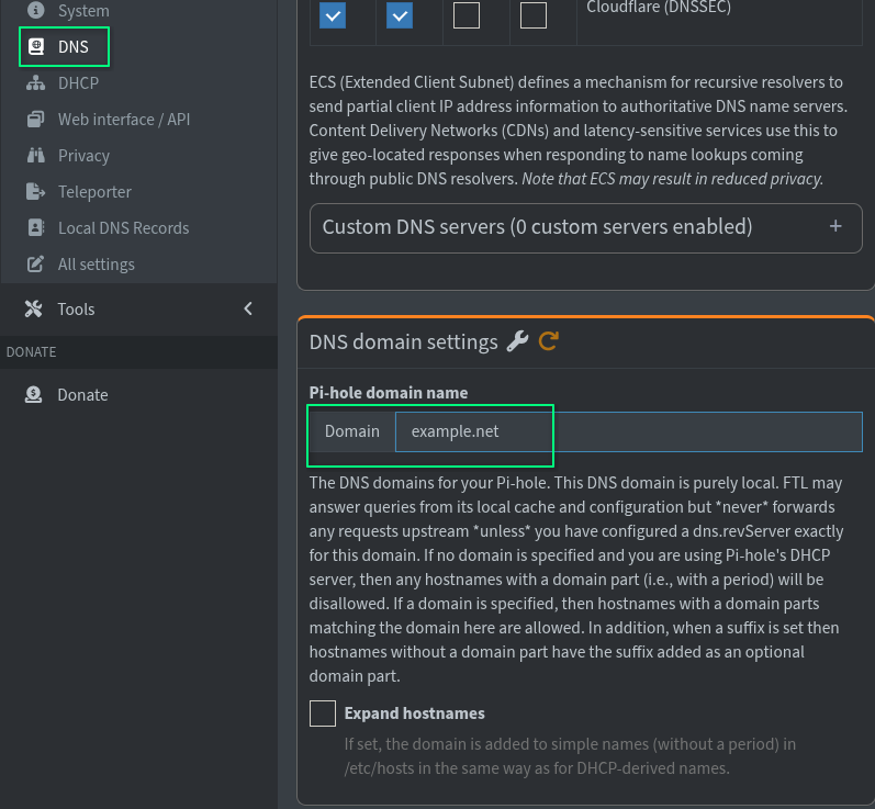

For my setup, I ended up using Pi-hole as the internal DNS override for the same public Nextcloud domain, and it works correctly for both internal and external access.
My setup looks like this:
  • Nextcloud AIO behind Nginx Proxy Manager
  • Public domain: cloud.example.net
  • Internal IP of the reverse proxy NPM: 192.168.50.10
  • Pi-hole IP: 192.168.50.5

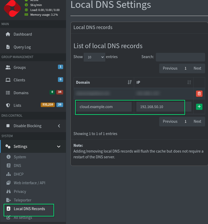

In Pi-hole, I configured (do not forget switch settings from Basic → Expert):
Settings → DNS
  • Pi-hole domain name = example.net
Local DNS Records
  • cloud.example.net -> 192.168.50.10
With this in place, internal DNS resolution returns only the internal reverse proxy IP, while external clients still resolve the public IP through public DNS.

My configuration matches yours except I did not set the FQDN in Pihole’s “DNS domain settings”. I have never changed this setting, still set to “lan”.
I set my FQDN in Pihole’s “DNS domain settings” and disabled “Expand hostnames” as you showed in your example but unfortunately nothing changed. I expected that it would not make any difference but was worth as shot.
I am still getting the mentioned warnings as soon as I add the DNS record to Pihole for my Nextcloud public domain pointing to my Nginx PM reverse proxy. As soon as I remove this DNS record and return to external access, the warnings disappear.
In my case, changing that setting actually made a difference.
Originally, Pi-hole was still using the default lan value in DNS domain settings, and with that setup I was not getting a clean internal resolution for my Nextcloud domain. It kept returning both the internal IP and the public DNS result.
I changed that setting from lan to my actual domain, and after that Pi-hole started resolving the Nextcloud hostname internally only to the local reverse proxy IP.
So for me, that change was important, not just the local DNS record itself.

I added the local DNS record for my Nextcloud public domain to my local DNS server (Pi-hole) pointing to my reverse proxy ip.
If I reload the administration page in the browser, all warnings disappear.
I disabled the port forwardings 80/443 for the reverse proxy (Nginx PM) in my router and now all the mentioned warnings appeared again and stay after reloading the page repeatedly. I enabled the port forwardings again and the warnings were gone.
