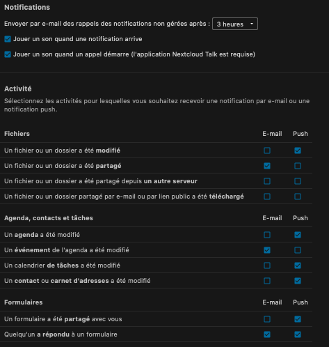

Can you show a full screenshot of https://yourncdomain.com/settings/user/notifications ?
Hi @szaimen
you’re always so fast, thank you so much.
Here are my screen shots:
Capture d’écran 2023-06-12 Ć  10.40.08
Capture d’écran 2023-06-12 Ć  10.40.15
The settings look good in general. I think after setting up the mail server only new activities will be send. BTW, did you also set an email address for your account in your personal settings?
