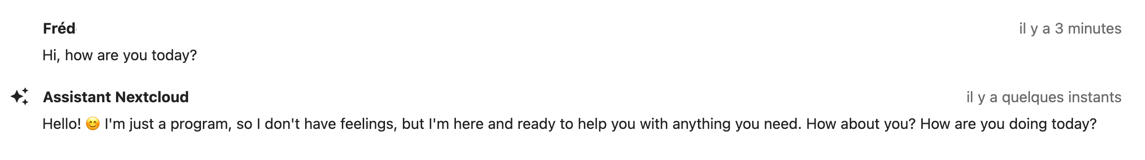

When I try to interact with AI Assistant, it’s very very very slow… Just for LLM average of 5 minutes to answer to, for exemple: “Hi, how are you today?”

This is the solution for my NextCloud AIO. Now, instant response.
set -e; while true; do docker exec -it nextcloud-aio-nextcloud sudo -E -u www-data php occ taskprocessing:worker -v -t 60; done
