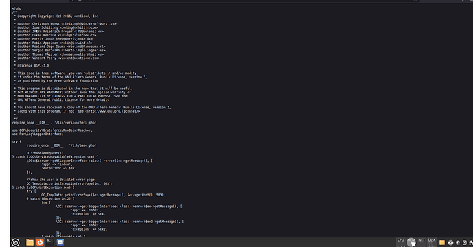

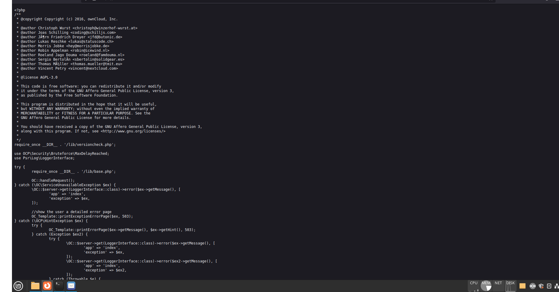

  3. When i go to my side this is the only thing i can see:
Maybe there is a Problem with php? Should i reinstall it?
