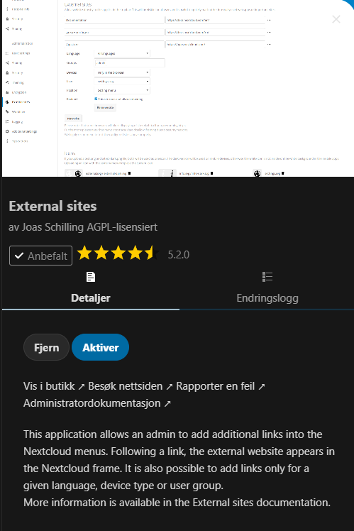

Looks like i solved it somehow.
I disabled the app β€œExternal sited”, and now all the errors are gone.
